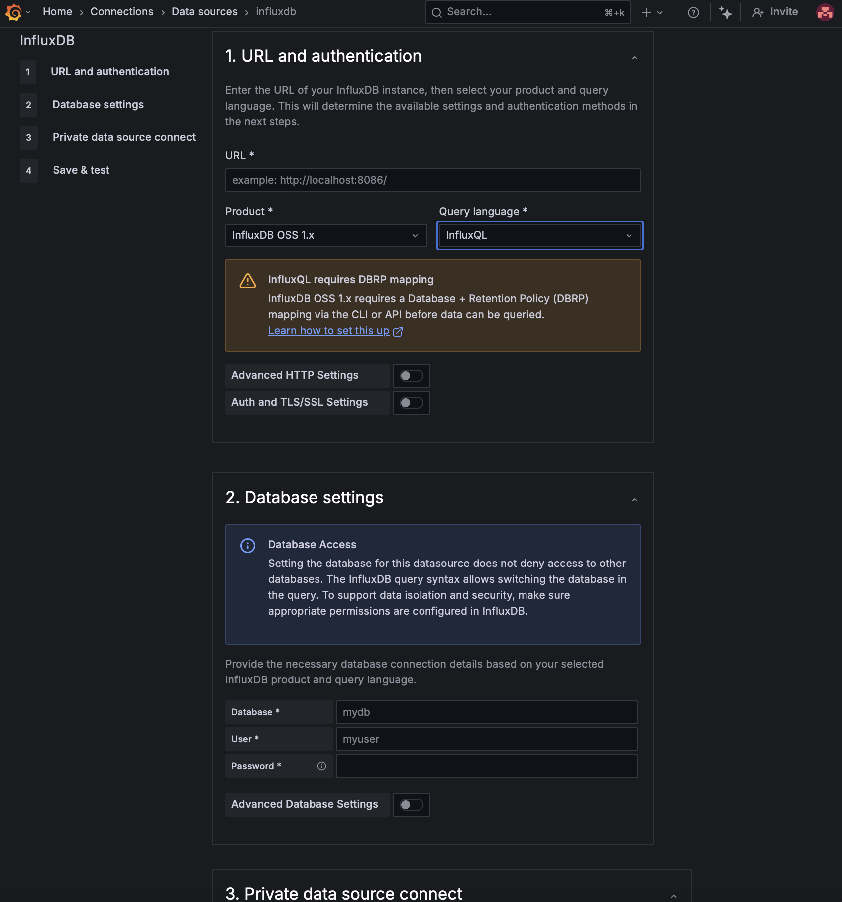

Configure Grafana to use InfluxQL
With InfluxQL selected as the query language in your InfluxDB data source settings:
  1. Under HTTP, enter the following:
    • URL: Your InfluxDB URL.
      http://localhost:8086/
    • Access: Server (default)
  2. Under InfluxDB Details, enter the following:
  3. Provide a Min time interval (default is 10s).
  4. Click Save & Test. Grafana attempts to connect to InfluxDB and returns the result of the test.

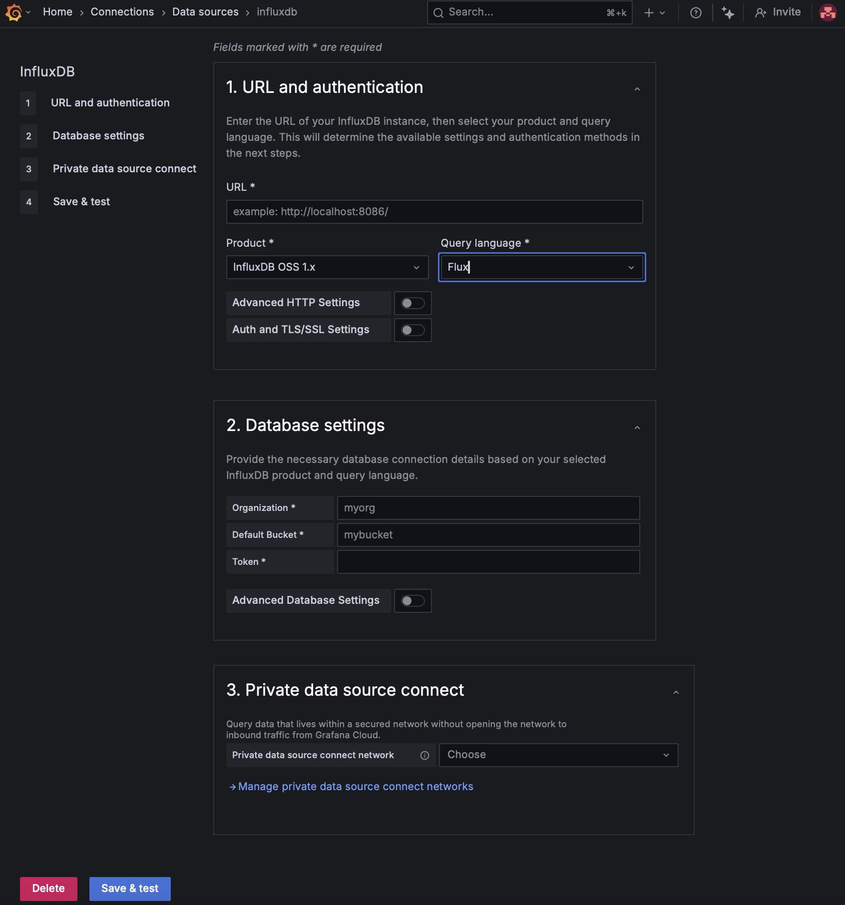

Configure Grafana to use Flux
With Flux selected as the query language in your InfluxDB data source, configure your InfluxDB connection:
  1. Ensure Flux is enabled in InfluxDB.
  2. Under Connection, enter the following:
    • Organization: Provide an arbitrary value.
    • Token: If InfluxDB authentication is enabled, provide your InfluxDB username and password using the following syntax:
      # Syntax
      username:password
      # Example
      johndoe:mY5uP3rS3crE7pA5Sw0Rd
      If authentication is not enabled, leave blank.
    • Default Bucket: Provide a default database and retention policy combination using the following syntax:
      # Syntax
      database-name/retention-policy-name
      # Examples
      example-db/example-rp
      telegraf/autogen
    • Min time interval: Grafana minimum time interval.
  3. Click Save & Test. Grafana attempts to connect to InfluxDB and returns the result of the test.
